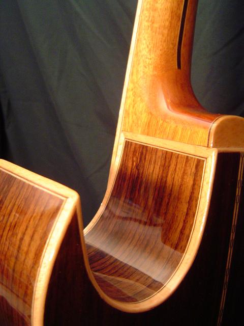

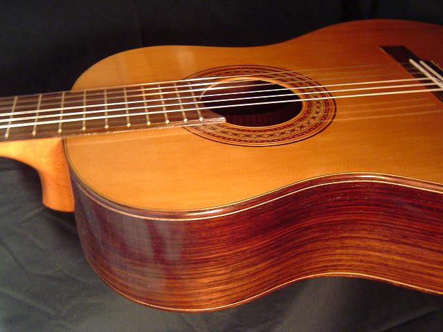

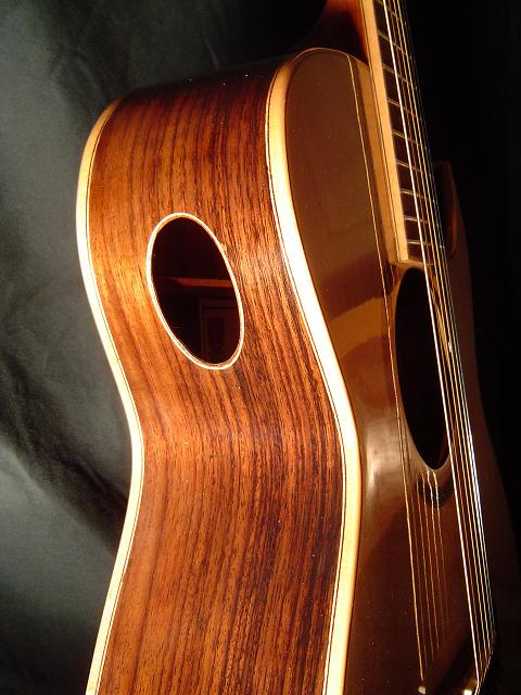

One classical and one steel string cutaway. The classical is French Polish for a finish and the steel string is Catalyzed urethane.

That is Beautiful, Love the Cutaway, reckon you could kill with that.

I reall like both those guitars. Very clean miter joints in the maple binding.

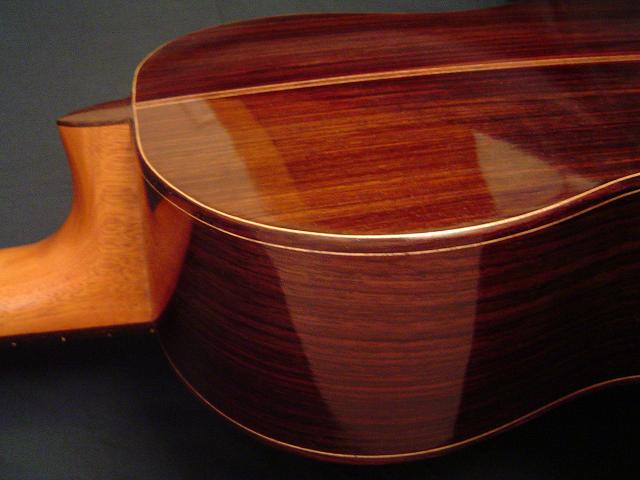

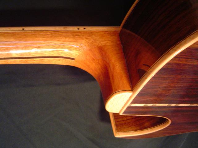

here you go with a couple of extras...

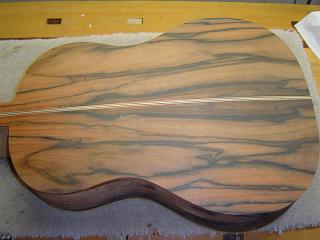

and this one should be done in a few more weeks.

I guess I'm the lucky one! I get to spend the night with the steel string tonight playing it. It has very even tone, and very loud! I'm going to be road testing it tonight to try to flush out any playability issues. But first run through in standard, DADGAD, and CGCGCE tunings have been right on. This guitar is very easy to play too! This guitar is a real keeper.

A question.
I have seen several builders put side holes in. What is the reason for this?
Is it just for looks?

Thanks for the backup, Robbie. Beautiful work--superb finish. I like the reflection you're getting!

Andy,
The purpose of side ports is that some of the sound is then directed toward the player so that they have a better sense of what is being heard by others...kind of like having a mini-monitor speaker pointed toward your ear. Some feel that it opens up the sound of the guitar.
Another feature of a side port other than sound is that it allows people to peer into the guitar to see the construction inside. If the inside is pristine then that can be a selling point.
There is no particular size for a side port...some like Classical builder Robert Ruck who drills 2 20mm holes in the sides on either side of the neck focus on function while other builders make the ports decorative shapes in varying sizes.
